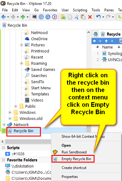

After emptying the recycle bin within XY the screen did not refresh until I click off of the recycle bin then back onto the recycle bin.

So you were positioned in the recycle bin (in tree and list I assume) and then used which exact command to empty it?
Re: Recycle Bin Refresh
Please see the attachment
- RecycleBin.jpg (236.8 KiB) Viewed 1949 times

Yes, I have this sometimes too. I have the recycle bin open in a tab in bottom pane, while I'm working in the upper pane. When I then use the tree on the left side to empty the recycle bin, the tab in the bottom pane did not get refreshed (updated).
I think this is just because xy does not update every tab every millisecond. BUT this does not only affect the recycle bin! If you're working with several tabs then they have a "delay" sometimes before you see the changes. Especially when the folders contents are modified be external apps or through a script.
For me I've added a refresh (#1001) to my scripts. In your case just press F5. I would not call this a bug.

It works perfectly here (Win 8.1 -- in both panes) so once again MS changed the notifications. I never-ending PITA.
So, let's see. You can log the events that are causing an auto-refresh in XYplorer.
1. Switch on the logger and make it send the output to debuglog. Paste this into the address bar and press ENTER:
2. Empty the Recycle Bin.
3. Show the debuglog. Paste this into the address bar and press ENTER:
I might be able to solve the mystery if I see the logged events...
I performed the steps and the recycle bin refreshed on it's own.
Here is the log anyways...JGM

- Posts: 65335
Log looks okay (and like here in Win8.1), hence it all worked as it should. I would need the log when it does not work to find out what could have been the problem.
