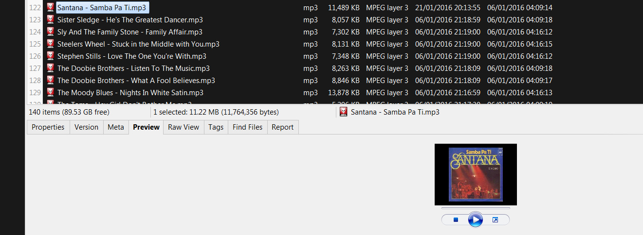

Hello
I really don't like how the preview now seems to use a mini version of Windows Media Player. It's a player I never normally use on my system. With an MP3 selected it now takes a long time for the mini player to even appear. It has no volume control either. It's awful. Is there any way to revert to the old preview feature or would that be a case of reverting to the previous version of XYplorer?
Many thanks.

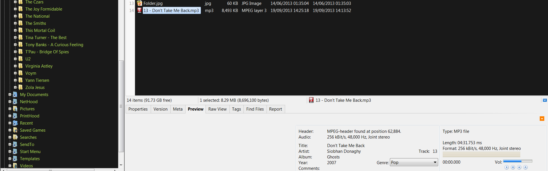

Well, as you can see, I'm not talking about a floating preview, just the standard info panel preview. I checked the ID tags and, within a folder of MP3s which are all ID3v2.3, some preview like this and some (most) preview the old way!
I used to have K-Lite installed but do not now and haven't for some time. I use Foobar for music and KMPlayer for video.

There is no getting back. IDv2.4 never worked in XYplorer's native interface (unless you installed KLITE).
                      without KLITE                   with KLITE
Before Preview 2.0    IDv2.4 FAIL                     IDv2.4 native preview
After  Preview 2.0    IDv2.4 works (preview handler)  IDv2.4 native preview
So: it only got better, nothing was lost.

Well, the so-called "native" support is not that native. :) It uses the system-native "DirectShow" interface. XY can only show what DirectShow can show. KLITE (and similar stuff) can pimp DirectShow.
