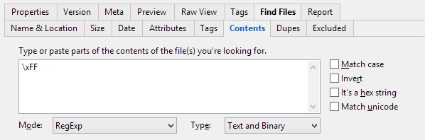

Searching for content in binary files using regex doesn't work correctly.
Searching for something like this works:
\x49
But searching for something like this does not:
\xFF
It can find only bytes in range \x00 to \x7F :bug: .
Seems something somewhere ought to be an unsigned variable instead of a signed one.

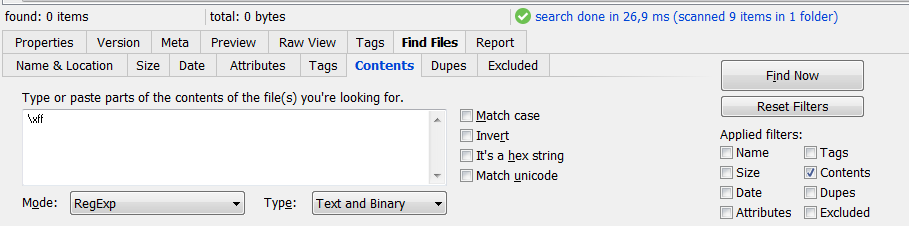

Interesting. Maybe it somehow depends on options set?
Here is mine:
I also tried with ::fresh, got the same result.

I originally tried to search something in a bunch of jpeg files, but now I tried to search for \xFF in entire C:\Program Files, and so far no hit (and there should be thousands of hits!). It just can't find \xFF at all. I will experiment with this further to see if I can make it work somehow :cry: .

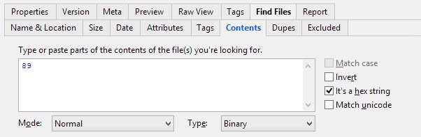

Confirmed. ATM I cannot solve this riddle.
I suggest you use XY's built-in hex content search meanwhile:
