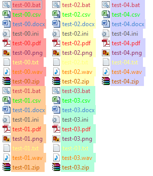

EDIT: I think making your switches '//m|' is all you'll need to do. You'll end up with highlighting like this:
Is that what you're after?

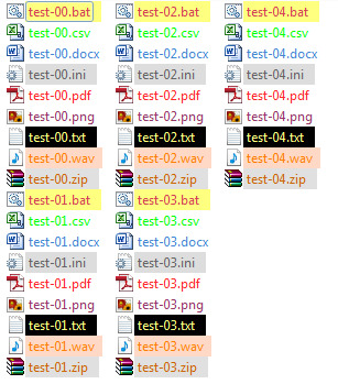

Then when you apply your ICFs you'll still get the font colors for those items that normally would have both colors changed. Like so:
And without the ICF:
