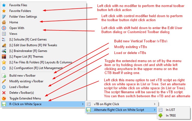

1) This update takes advantage of XYplorer's new capability to detect the modifier key pressed when you click on a menu item. This script is very well suited to use this feature in that now you'll be able to execute both the Left and Right actions of the user CTB's or XY built-in Toolbar buttons. So, that means in this version of the script:
- If you left click on a menu item with no modifier, the script brings up whatever you have assigned for the normal Left-click action of the CTB or in the case of an XY built toolbar button it will execute that button's function.
- If you left click a menu item with a modifier held down, either Shift or Control, the CTB's or XY TB button right click action will be performed.
- If you hold down both the control and shift while you left click on a menu item, the "Edit User Button" dialog opens for that CTB or if it's a standard XY button the Customize Toolbar dialog opens.
It's very helpful in using this vTB script, just as it is on the normal TB, if you clearly define in the CTB's caption the actions of both the Left and Right click of the mouse. For example [L] Layout Manager [R] Session Manager - see the picture above. You can even have the actions for caption/tooltip on separate lines if you edit the XYplorer.ini and put a "¶ " between the two.

- Provided an option to modify existing toolbars. The existing TBs will be pre-checked with the previous order maintained and will be located at the top of the listing.
- Added option to assign the Vertical Toolbar script to the Right Click on White Space in the List. The really nice thing about that with this type of script is: if you have multiple vTBs you can load them via the menu and whatever vTB is current will be the one loaded on right click on white space. So it ends up being quite easy to change menus displayed via right click on white.
- Added an additional option when you hold a modifier key like control or shift down when you click on the above new Right Click menu item. This option allows you to assign an alternate script to Right Click on White Space in the List. So if you have another script you use regularly you can assign that script via that menu. This will allow you to easily switch between the Vertical Toolbars script and another script of your choice.

This version allows the user to toggle the extended or addon menu on and off. Most of the time we really don't need to see the extended menu. This can be accomplished through the menu (when visible) or by holding down control & shift while left clicking on any menu item (not the extended menu). L-click of the mouse is still same as hitting the left click of the CTB . Control left click is the same as right click of the toolbar button. Shift left btton is now the Customized Toolbar dialog or Edit User button as applicable.
Hopefully I made the assignment of the vTB script or another script of your choice easier and more straight forward to accomplish for Right Click on White Space. You can now also make those choices for the tree as well as the list. Extended menu status (ON or OFF) and alternate right click on white space scripts are saved to a ini section of the script itself. Thanks to FluxTorpedoe for that idea.

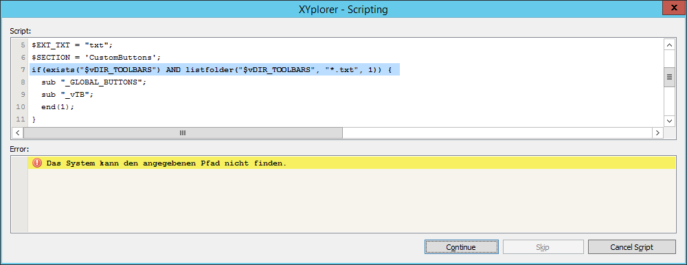

Problems:
On first startup of the script:
After saving the first toolbar:

- Darn I thought I had checked the use of listfolder if/when the folder didn't exists. I went ahead and removed the listfolder check for the existence of a *.txt (vertical toolbar) and go with strictly the check for folder existence. Unfortunately you can't use wild cards with SC exists on a file.

I uploaded another version which corrects the script for highends comment above...at least I hope so. Please let me know highend if you still have a problem. It gets a bit tricky because you can specify icons for CTBs with only the icon name with out the <xyicons> or you can have the full path spelled out, but of course you can't use an icon name without a path OR <xyicons> in a menu.

Still the same error (as long as vToolbars doesn't exists). It's even worse now, you get three script warnings instead of one :D

So sorry highend and Filehero. I tried multiple 'if' conditions including listfolder and before sending I forgot the second closing parenthesis on exist on line 9. So if you would go ahead and add it or re-download and hopefully it should work. I updated the file on the first post as well to v1.02. Thanks for testing. :oops:

v1.0.2
Ok, no further warnings, when the folder doesn't exist.
