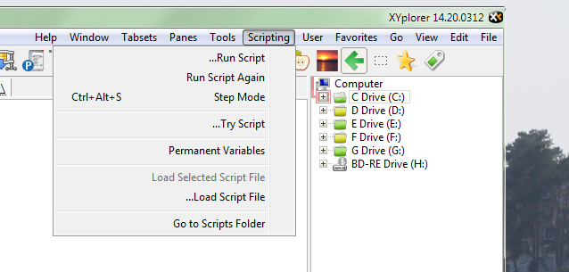

Posted: 06 Jul 2014 23:00
by klownboy
Take a close look at this pic...you can achieve some very strange results experimenting with AHK and "winset" and "winget". :naughty:
Yes, that's the right side of XY and no, when I started I didn't have the nav panel on the right either. :) XY for lefties (or is it righties)!
