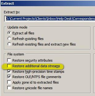

stephr1 wrote:So, going forward, how would I "clear the stream" or actually change it (can I, and to what) so I don't run into this problem in the future.
Simply go into the settings of your zipper/unzipper and untick the appropriate setting. Some zippers allow this on a per file basis, for others it's a permanent setting:
I rarely need to check up on this, however, since none of my clients uses this setting, anyway.
To make sure you don't, either, also check your compression options:
Re: Odd Behavior, Part Deux
