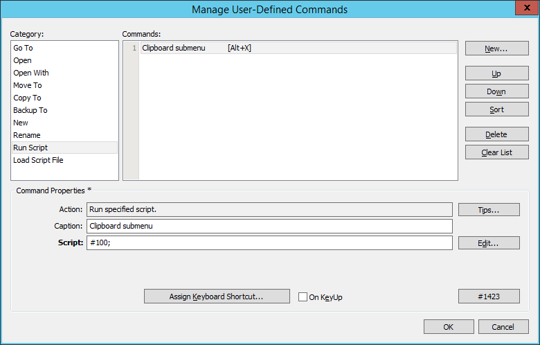

Highend is right. Please read the help of UDC and the "popupmenu" script command bit more closely and you will be able to create the desired menu.
ADDITIONALLY: my very primitive example is here.
Posts: 14744
Re: More Customized Context Menu-Don't Expand Items
For what he asked for it's even simpler:

Thanks for your help trying to create a workaround that will provide such ability currently. But neither of these are more helpful or useful. They do not solve what i was looking for or make it faster/easier than what is currently built in. I might as well just use the shortcut (ctrl+p) or mouse>>expand. With the UDC, I cannot right click a file and have it appear right there, correct? Anything else will take extra effort for the same effect.
I wanted the ability to put any command at any place in the context menus.
To have a way to set where commands are grouped. It is a matter of re-arranging existing commands in the current list.

so you are saying the UDC does nothing more than change the short key? I could just customize the keybeard shortcut. why use UDC?
