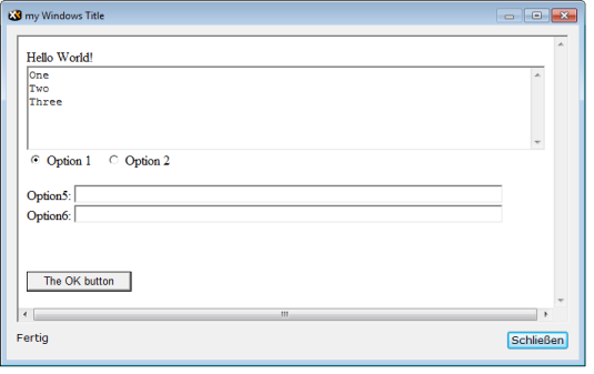

Add some HTML code to add some functionality:
$TextAreaDefault = "One<crlf>Two<crlf>Three";
$myXYVariable = html('<HTML><FORM method="GET" action="xys:">
			    Hello World!<BR>
				<TEXTAREA name="BigTextArea" rows=6 cols=75>' . $TextAreaDefault . '</TEXTAREA><BR>
				<INPUT type="radio" name="myOption" value="Option1" checked>  Option 1 &nbsp; &nbsp;
				<INPUT type="radio" name="myOption" value="Option2"        >  Option 2 <BR> <BR>
				Option5: <input type="text" name="Option5" size="80" Value=""> <BR>
				Option6: <input type="text" name="Option6" size="80" Value=""> <BR>
				<BR><BR><BR>
		    	<INPUT type="submit" name="Submit" value="The OK button">
		    	</FORM></HTML>', "700", "630", "my Windows Title");
Awaited result (resized):

I managed to (is that right? :?:) ensure that $myXYVariable is filled with a valid target.
But
' ', "700", "630", "my Windows Title"' is displayed at the lower portion of the HTML interface
and a " ' ", at the left of the "Execute One". How do I fix that...?
Thank you very much!
-any example on how to work with Initialize/Terminate, Stefan or anyone else...?

by PeterH
I'm afraid that html("$a") only gives one operand to the html-function, while I think you also want to supply width, height and caption?
So I think you should move the latter from inside the heredoc to html($a, 700, 630, "my Windows Title").
(You may add the unneeded quotes again :roll: :D )

Posted: 13 Oct 2013 00:49
by SkyFrontier
Thank you, PeterH! That solved.
