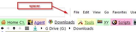

I noticed the
I noticed the
text: notation in the name block of a CTB will provide a nice smaller width spacer for your toolbar. The cool thing is you can assign a script for it as you would any other CTB. I used it as shown in the pic for when I display the Address bar to the left of my toolbar set #2 with menu items on it (see script above which changes from toolbar set #1 to #2 (with AB). Of course you can make an extra wide one as well.To see the attached files, you need to log into the forum.
