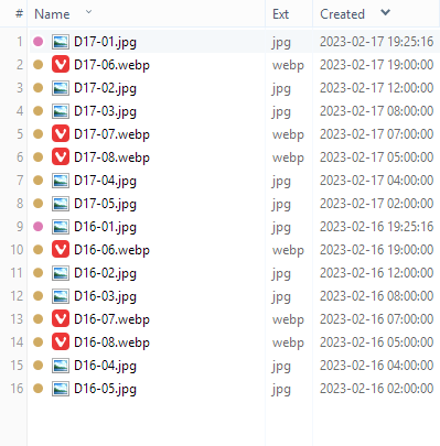

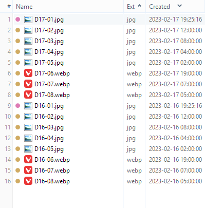

Yes, SortSecondaryByExactDate=1 would fix it, but then you get almost no secondary sorting because the primary groups are so small (only files with exactly the same timestamp).
With SortSecondaryByExactDate=0 you get primary groups for each day (time is ignored). And then 1. Created / 2. Ext yields a different picture from 1. Ext / 2. Created.
PS: These screenshots are from the fixed version I have here (using BubbleSort).
Re: Miscellaneous - Questions
Posted: 18 Feb 2023 11:26
by MaxEnrik
The 2nd one is what I am looking for.
Posted: 18 Feb 2023 11:29
Well, the new beta is there. Try it.
