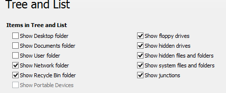

I own a Nexus 5 but it doesn't show up at all in the tree (non locked & refreshed). Neither when using MTP or PTP. Current beta.
Both modes work fine in Windows Explorer...

Just to make sure, this has to be ticked: Configuration | Tree and List | Items in Tree and List | Show Portable Devices

I can't, it's greyed out...Just to make sure, this has to be ticked: Configuration | Tree and List | Items in Tree and List | Show Portable Devices

Are you working on XP? In that case (assuming you have WMP 10 installed) you have to tweak it:
ShowPortableDevices=1FAQ | XY News RSS | XY X

No, not reallyAre you working on XP?
I've tweaked the config and now the option is still greyed out, but at least it has a checkmark.
My Nexus 5 shows up when I right click into the tree (in the context menu)
but I can't do anything with it because of:
