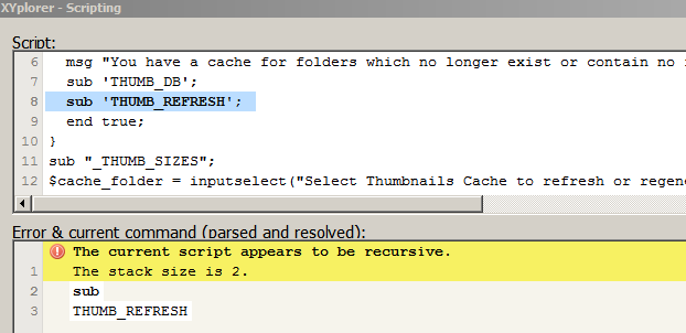

If a backup folder is not present, I get XY's error dialog telling me "Invalid parameter: F:\......\thumbnails
One machine triggers this error when I run Refresh (current & subs)

ScriptRecursionWarningOff is set to "0", not "1" as you suggested. The wording confuses me, if "1" means ON, does that mean the Warning is OFF but recursion may be ON nevertheless? Anyway, it's "0" and that might be the problem. I don't remember touching it, though. Maybe it got changed around by the XY update? Earlier XY versions never caused these error messages. :evil:
That tweak only turns off the warning, and doesn't stop script recursion.
The SC settingp can change the setting permanently. Maybe you ran some script which had used that SC.

Thanks, Sammay. If I read you correctly, I could have simply clicked "continue" instead of canceling out of the script? It takes a daring user to continue with a dialog that pops up like that :eh:
Proceeding after a message box is one thing, but with an open-hood scripting dialog that says "error", well, you gotta have some nerve to risk an endless loop with unsaved work under way in a multi-tasking environment.

Hi, here's another update to the ThumbnailMaintenance script (version 1.14). I noticed that the new cleanup function of stray "dat2" files wasn't working as it should. So I wanted to post this correction and update. I had 2 variables reversed in one command line which causes it to hiccup. With this change the script also checks for stray "dbits" file along with the dat2 files in the <xythumbs> folder. So it should clean out strays of either type. Now if you have matched pairs of dat2 and dbits files that are old, the script does already check for folders which no longer exist or folders which no longer contain image files and will pre-check the entries in the database listing. Beyond that I'm not sure if there's anything else I can do with"old" matched pairs without knowing how these stray matched pairs of these files is occurring. It may only occur in situation where you've had the cache turned off and on.
Thanks Sammay for the clarification on recursion. Yes it is just the warning that is turned off. I turned the warning off over 2 years ago based on a recommendations in other scripts [yes, and I'm still here]. The script is simply turning back on itself which many scripts do so setting it to "1" shouldn't be a problem. Stef if you are reluctant to set it to "1" yes you should be able to simple click continue.

Sorry: I didn't read all, but saw the problem with recursion.
So a question: shouldn't a script using recursion set Setting 'AllowRecursion', 1; to avoid problems?
(Set it *not* permanent!)
The current script "knows" that it's needed, and the user doesn't lose protection for other scripts.

AllowRecursion: Show no warning on script recursions
See, it controls only the warning dialog. Recursion itself is active either way.

Thanks PeterH, I didn't look at it that way since I've encountered so many scripts that need it set to "1" to avoid the message. I believe only one or two portions of the script need it anyway. Most of the normal use script options would not need it. So maybe on the next change I'll add the temp setting change.
And yes, thanks Sammay, I rechecked the "setting" in help, it is only the warning being suppressed.

think Peter's suggestion could be recommended if the recurse-warning dlg was more friendly.
it's now just too scary at first glance.
