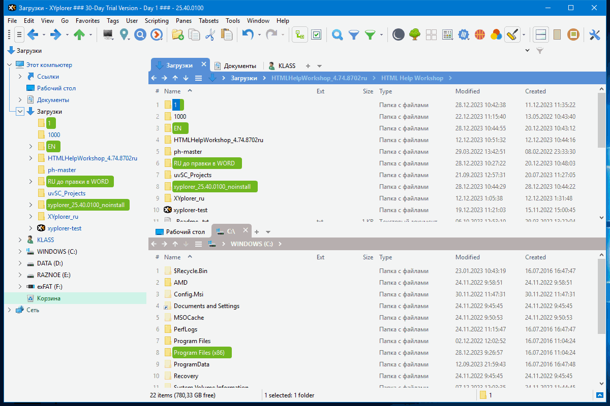

The thing is that without checkbox "Expand tree nodes on browse" by double-clicking a folder in the list, by selecting a favorite folder, or by using address bar, tree node, that is not expanded still expands, regardless of the state of checkbox.
Therefore, I ask you to give an example of such an action, after which the tree node does not expands.
Probably, it is not for nothing that you wrote earlier that the old name of the setting for the tweak feels a bit weird and the caption is confusing users.
So far I have not found an action that does not expand a tree node without checkbox "Expand tree nodes on browse"
KLASS
- Posts: 233
- Joined: 06 Dec 2014 12:28
Re: Russian
Windows 10 Version 21H2
- Posts: 67012
Re: Russian
1) fresh instance
2) double-click C: in list
3) C: is selected in tree but NOT expanded
1) fresh instance
2) check "Expand tree nodes on browse"
3) double-click C: in list
4) C: is selected in tree and IS expanded
1) fresh instance
