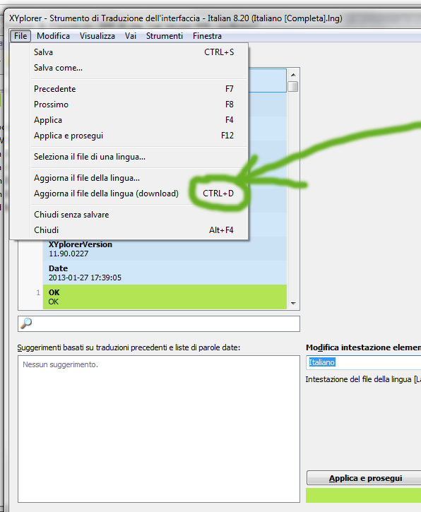

I noticed that in the ITT all the keyboard shortcuts are in upper case even if "Ctrl" is properly capitalized in the translation. Bug, not big deal, or what?

- Posts: 67238
Re: Italian/Italiano (it-it; 1040)
Don't know what you mean.Marco wrote:@Don: thanks for the screenshotI noticed that in the ITT all the keyboard shortcuts are in upper case even if "Ctrl" is properly capitalized in the translation. Bug, not big deal, or what?
Marco
- Posts: 2354
- Joined: 27 Jun 2011 15:20
I already checked string #23 and it is properly capitalized as "Ctrl"
- Posts: 67238
Ah yes, bug. The ITT menu shortcuts are not completely localized. Next time...
