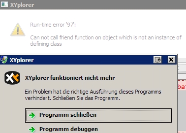

Hi! I am again just using this thread to report a crash with the version 25.50.0300. I am aware that I am actually not supplying any useful information - I simply wanted to at least report the fact.
Although I was not reporting it, previous versions did crash from time to time. That was without any message. In all cases that I experienced it happened short after creating a new subfolder via right click in the list, then "New items", then on one predefined folder with date in its name. However, my perception is that it does not happen then (the folder indeed gets created) but soon after that, probably after I click in tree on the parent or sibling of a newly created folder. This is at least my impression. Don, if you remember, you once already tried to recreate something like this, "clicking as a woodpecker".
Anyway, this time a message appeared (before the Windows message): "Can not call friend function on object which is not an instance of defining class". The whole issue is (for me) very rare and does not bother me much.
Win 10 Pro 64bit
- Posts: 67133
Re: xyplorer crashes unexpectedly
There are some useful details in this report, thanks. Of course, I could not reproduce it now, but the moment will come when it happens, and the following moment will be the one when I fix it.
Hi again!
I just got it again, but under another circumstances and only with a windows message (XYplorer funktioniert nicht mehr). Everything what follows was happening in the list:
Some 150 - 200 files in list. Right click on empty, new folder, manual inline renaming. Select some 30 of them, including the new folder. Tools menu, right click on selection button, invert selection. Ctrl-X. (My intention: Move these currently selected into the newly created subfolder of that folder.) Selected files are being marked with a vertical red line. All as expected. Double click **in list** on the previously created subfolder (in order to get there and make Ctrl-V). Crash on that double click. The tree of the so frozen app (with Win msg in front of it) shows the new subfolder as the current one (according to the branch background color), but the list still shows the content of the parent folder (i.e. is still not in the empty subfolder).
CSI, good luck!
CSI, good luck!
