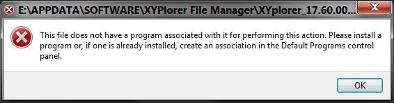

Update: Drag/drop/context menus work fine in every other program when they fail in XY. Also, it appears file associations in XY are lost. If I double click on any file I get this error dialogue:

1. To turn off Configuration | Shell Integration | Drag and Drop | Use standard shell drag and drop is no option for you?
2. Do you have the FastPictureViewer Codec Pack installed? (Years ago I have seen some issues caused by this that were a bit similar.)
3. File associations in XY are lost: that's totally unrelated to this topic. Please open a new thread and I will try to help.

Item 3: The reason I reported this in this thread is that it occurred after drag/drop failed. I have NEVER had this happen before. When I had previous drag/drop fails, I never double clicked a file before I restarted XY.
