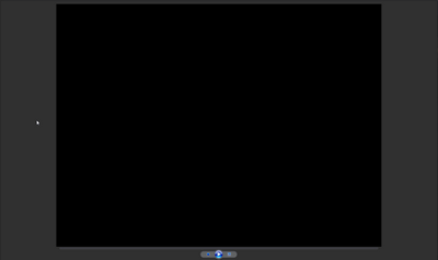

Are there some kind of width limits to the floating preview? If you look at the screenshot below, you would notice that no matter what, the width of a video is constricted for some reason. Is there no way to widen that? It's a bit odd especially preview widescreen videos (which is most videos these days?)
2015-12-24 00_21_01-FP.png (3.08 KiB) Viewed 3433 times
Posts: 65064
It appears to be limited to 100%. The preview handlers do not support zoom. (Another reason to keep the preview tab, where XYplorer supports zooming videos!)
