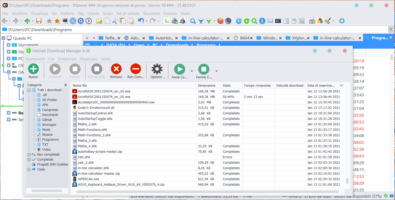

From your answers, I deduce that it's probably my problem. I am attaching a gif of the problem: the duration of the explorer.exe screen depends on the workload of the pc, in this example I had nothing else open, but sometimes it can even last 1 or 2s.
