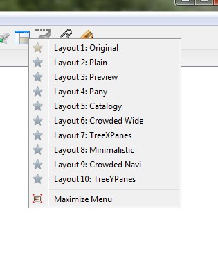

Something odd just happened on the Layout Manager menu. The golden star for the active layout is now gray instead of gold.
I've been poking around in the ini and xys files, but haven't been able to find out why. I've attached a picture of what I mean. It's only happened on my laptop not a desktop computer. I tried going to other layouts with the same result. I don't believe I've changed any settings (i.e., color settings etc.) in the XY configuration menu that would explain it. I'll be doing some more checking on the desktop when I'm home again.

I checked my desktop and the Gold Star indicating the active layout is indeed golden unlike on my laptop as I reported last night. I've been looking through the Layout Manager files and I think you use the XY internal icon :favs for the golden star and :favfiles for the blue inactive layout in LMMeny.xys? I've applied those internal XY icons to another User Button, both the :favs icon and the :favfiles icon and they show up fine on the button bar on both the laptop and desktop computers so I'm not sure why the gold star is not showing as gold on the laptop's Layout Manager menu...yet...
Oh by the way, when poking around I did notice in the layouts.ini file that there was no space between the two user added layouts as there are between the other layouts pre-sets you have on original installation.

A couple of times I noticed this behaviour too - but like you only on me notebook. I blamed it on my notebook configuration because I couldn't really find any reproducable settings. This is indeed a really strange one. The only thing I could possibly try is to make the fav icons external like all others and hope it gets fixed this way.
thank you for reporting and doing the first analysis.
You're right, for the fav icons I'm referencing XY's internal ones.klownboy wrote: I checked my desktop and the Gold Star indicating the active layout is indeed golden unlike on my laptop as I reported last night. I've been looking through the Layout Manager files and I think you use the XY internal icon :favs for the golden star and :favfiles for the blue inactive layout in LMMeny.xys? I've applied those internal XY icons to another User Button, both the :favs icon and the :favfiles icon and they show up fine on the button bar on both the laptop and desktop computers so I'm not sure why the gold star is not showing as gold on the laptop's Layout Manager menu...yet...![]()
This is true. Since I'm completely relying on the XY script Api here I haven't any direct control on the layout when writing to the ini file.klownboy wrote:Oh by the way, when poking around I did notice in the layouts.ini file that there was no space between the two user added layouts as there are between the other layouts pre-sets you have on original installation.

It is indeed strange that you had the same issue with the gold star appearing as gray on your lapptop as I did and not on your desktop. My 2 desktops and my laptop all have Windows 7 installed. At first I was thinking it may be a operating sytem issue, but I don't think so. I was planning on adjusting Windows colors and themes to see if it made a difference. I had already played around with XY internal colors to see if that may have been the issue, but it didn't make andy difference.
I noticed you had a "favorites_16x16.png" file, (which is a golden star) in the resources/help/images folder. So I converted it to a ico and then placed it in the resources folder. Then I changed the line of code to refer to it as you refer to other external ico files in LMMenu.xys, "$ICON_PATH\Favorites_16x16.ico". I did this for a desktop (which had no issue) as well as the laptop where I had the issue and the gold star shows up fine (as gold) on both...strange. I hope you don't mind me playing with your code. I figured I'd give it a try at least until we can figure what caused the issue.

To make matters worse, on my notebook I could see this behaviour only on a fresh XY installation (when putting the plain xy exe file somewhere else and just add the script directory underneath /data).klownboy wrote: At first I was thinking it may be a operating sytem issue, but I don't think so. I was planning on adjusting Windows colors and themes to see if it made a difference. I had already played around with XY internal colors to see if that may have been the issue, but it didn't make andy difference.
Frankly, I hate such findings. They could take days to hunt down, if ever. This is why reading the next paragraph just made my day.
You already approved my fix will work, thank you very much. The five golden stars and a big applause go to Ken!klownboy wrote:I noticed you had a "favorites_16x16.png" file, (which is a golden star) in the resources/help/images folder. So I converted it to a ico and then placed it in the resources folder. Then I changed the line of code to refer to it as you refer to other external ico files in LMMenu.xys, "$ICON_PATH\Favorites_16x16.ico". I did this for a desktop (which had no issue) as well as the laptop where I had the issue and the gold star shows up fine (as gold) on both...strange.

I returned the LMMenu.xys code on the laptop back to using the internal XY icon, ":favs" mainly for testing purposes. I was also suspecting the behavior might have something to do with the icon caches. I remember reading somewhere in the forum, Don's reply to a question concerning speed of the menu. He stated that icons where cached so the speed shouldn't be affected.
Because of that I flushed out the icon and environmental caches under the view menu and also went to small icons on the toolbar menu to see if the small (16x16 size) icon was affected since we already knew the larger (24x24) size ":favs" icon looked fine on the toolbar. I was hoping to see the small (16x16) ":favs" icon on the toolbar grayed out since that is the size off the gold star on your Layout Manager menu, but no, it was gold as it should be. I really thought the issue might be due to the cached icons. I suppose not unless the icons are not completely flushed out and rebuilt, or the original internal icon has become corrupted for some reason. That's not likely since they appear correctly when called into use by XY. It boils down to, for some reason it's shows properly when XY uses it internally but not when it called out in your script. I suppose next I should use the icon ":favs" in a different script to see if it shows grey instead of gold. Sorry for thinking out loud.

As a quick followup to my last post...please read first...I used the XY internal ":favs" icon (16x16 size) within another script on my laptop and it did show up a greyed out instead of gold. So, I suppose that tells us it's not your script that's the problem, it's any script that utilizes the ":favs" icon. That blasted ":favs" icon shows up as greyed out in lieu of gold on our laptops anyway....
Ahh, but why only on the laptops?

So I will add a dedicated fav icon.
thanks for already clarifying this.klownboy wrote:As a quick followup to my last post...please read first...I used the XY internal ":favs" icon (16x16 size) within another script on my laptop and it did show up a greyed out instead of gold. So, I suppose that tells us it's not your script that's the problem, it's any script that utilizes the ":favs" icon.
Good question. In my case, the only apparently relevant difference is my notebook runs on Win 7 Pro 32 whereas my private desktop is based on Win 7 Pro x64.klownboy wrote:Ahh, but why only on the laptops?
