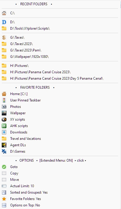

RecentFolders&Favs script update v 1.1. The script is based is based on LittleBig's nice script, CleanRecent. It was modified to display recent folders and Favorite folders with options to goto, copy, or move files to those folders.
Someone had mentioned in another thread about the capability to copy or move files to Favorite Folders. I thought my old version of CleanRecent was able to do that. I was wrong, for some reason I had the capability to copy/move (along with "goto") to the "recent folders", but I didn't provide that option for Favorite Folders. Well essentially that's the main reason for this revision. To use the copy/move to option, you must have files selected beforehand. If you don't, you'll get a message. So, keep in mind if in the previous use, the copy or move to option was selected and you then run the script again without having files selected, you get a message. Of course, you wouldn't get a message if you're using the "goto" option or that option was previously selected.Reminder as in the previous version, you will need a execution line similar to this whether it be in User Defined Commands (Category: Run Script) or a CTB:
load "<xyscripts>\RecentFolders&Favs_v1.1.xys", "_loadrecent"; load "<xyscripts>\RecentFolders&Favs_v1.1.xys";To see the attached files, you need to log into the forum.
