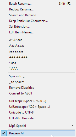

2) The settings affects those other Rename Special operations in the menu that have no own dialog. It's identical to the "Preview All" option at the bottom of the menu.

1) Wow, thank you, it became inivisible a couple of days ago when optimized something...

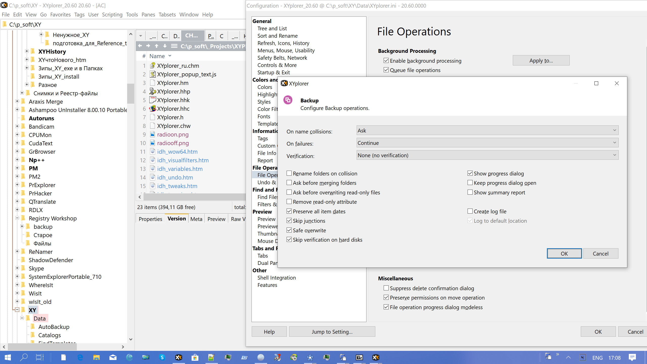

You have changed something in the sizes of pop-up (not XY and XY) dialogs. In version 20.60.000 they working properly.
For example dialogue with string "Overwrite Existing Item?"
(for example file XYplorer_ru.chm is opened and I'm trying to rename other file as XYplorer_ru.chm)
or Configuration|File operations.. dialogue after button Configure... (backup and custom copy operations)

I don't understand. they working properly? they are not working properly?

Re: Russian
yes in 20.60.000 I can see all contents of dialogs and all buttons.
in 20.60.0007 all changed.

Re: Russian
hm, both XYplorer_20.60.exe and XYplorer.exe are in XY root path.
Screenshots you have seen.
screen resolution:
Screen: 2560x1440, 1/1 (Primary), Virtual: (0, 0) - (2560, 1440), Work: (0, 0) - (2560, 1388)
difference
20.60.0000
Screen DPI: 180 (187,5%), twx: 8, stretch: 1,5
20.60.0007
Screen DPI: 160 (166,666666666667%), twx: 9, stretch: 1,5
I did not change DPI.
screen resolution:
difference
20.60.0000
20.60.0007

Re: Russian
according to Windows 175%
in the same place where is XYplorer.exe I have
XYplorer_20.40.0.9.exe
XYplorer_20.30.012.exe
XYplorer_19.50.0109.exe
XYplorer_19.50.0004.exe
XYplorer_19.30.0001.exe
They all shows me Screen DPI: 180 (187,5%), twx: 8, stretch: 1,5
- Posts: 67008
Re: Russian
I'm currently checking Screen DPI: 180 and there are some display glitches in ALL versions, no difference between 20.60.0000 and 20.60.0007.
So, WOW, good find!
Going to work...
So, WOW, good find!
