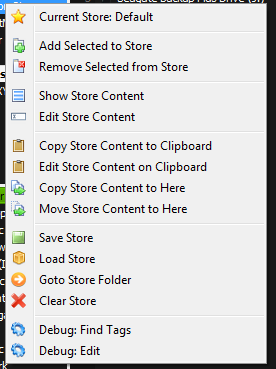

yusef88 wrote:when the debug button should be used.. big thank you :appl:
Aaargh. It shouldn't be. I removed it. You can redownload if you wish. Basically you don't really need to use it unless you want to take a look at my code. That debug menu makes it easier to open it in notepad.

Re: Selection Store 1.0 (March 25, 2014)
Posted: 26 Mar 2014 00:36
by yusef88
yes,looks pretty without it.. thanks.
