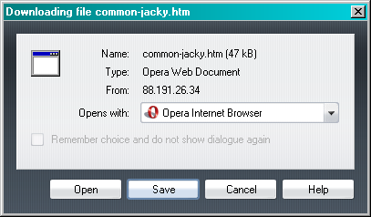

Maybe somebody already mentioned this, but when you download common-jacky it saves as common-jacky.htm. Change the htm extension to xys and the updater should work normally.

serendipity wrote:Maybe somebody already mentioned this, but when you download common-jacky it saves as common-jacky.htm. Change the htm extension to xys and the updater should work normally.
hmm... when does that happen ? I just tried again and I am asked to save a file common-jacky.xys :?
Happens to me too, but only in Opera (9.64):
In IE it's downloaded correctly as .xys. Don't know why Opera thinks it's a .htm file...

Pagat wrote:
Oh yes, thats right! i never thought it could be a browser thing.
