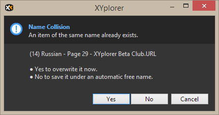

---------not found---
[messages].No to save it under an automatic free name.
[messages].Yes to overwrite it now.
I should see what means this "It'.
As far as I'm concerned, this lines is from here:
v19.60.0110 2019-02-18 22:03
* Drag & Drop from Browser: Now when dragging URLs from the browser address bar to XYplorer you are confronted with an overwrite prompt and some options. Before, the file was unconditionally saved under a new free name.

- Posts: 67010
Re: Russian
Yes, it's from here:
Now that I see it I find the wording not very good. The "it" refers to different items in each statement. I might try to improve this later...
