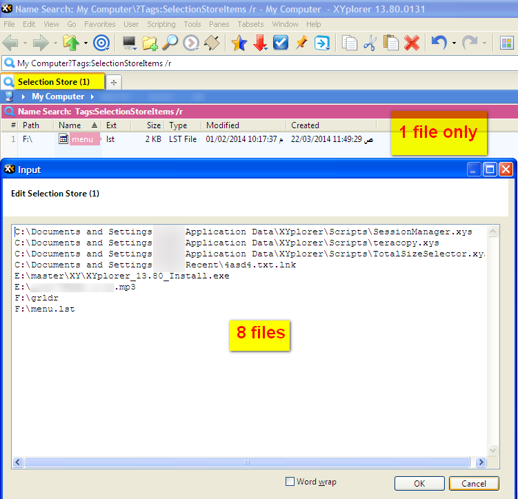

yusef88
Posts: 1148
Joined: 28 Jan 2013 03:50
Location: Windows 8.1 32-bit
Re: Selection Store 0.1 (July 24, 2013)
Post by yusef88 »
hi Enternal
please check attached video;I just add 2 files to default store, from where the other items came?
___________
show store item(s) . please make it open in new tab
__________
suggest to prevent visual distraction
