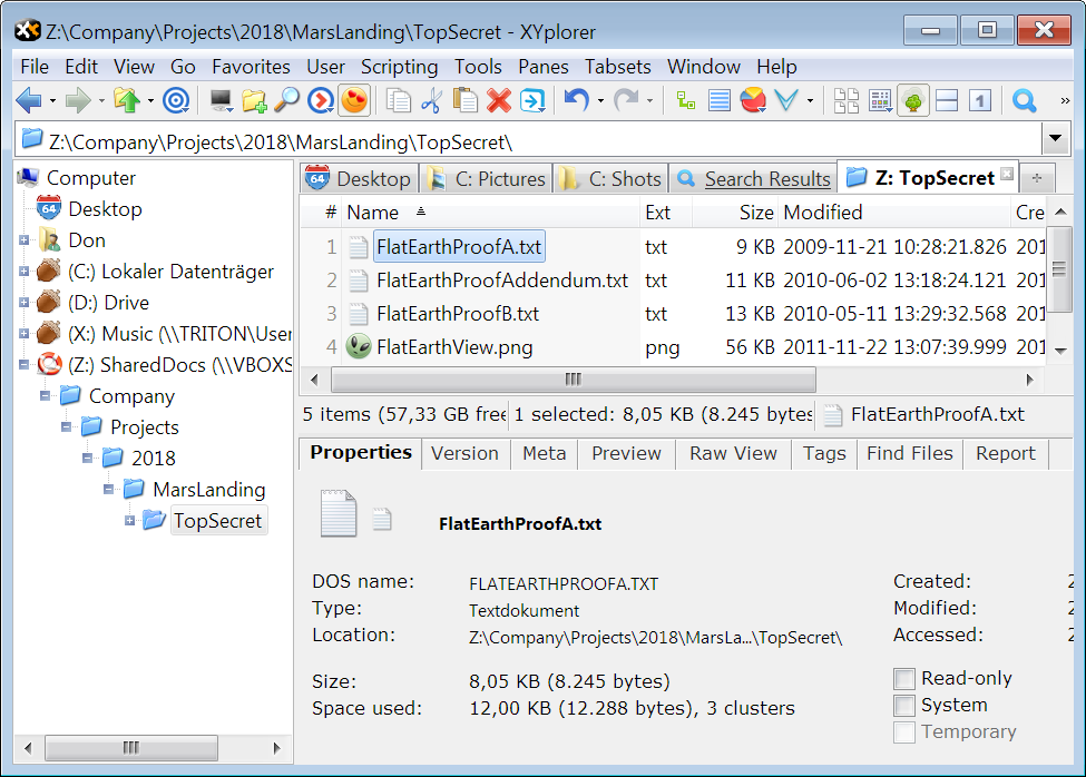

Configuration/Fonts states that for buttons, label & dialogs the font size cannnot be changed.
On my new 15.6" HD sceen (1920x1081, Windows
this restriction makes a lot of items between 1 and 2 mm high, which is extremely small. This is very disturbing with the heading of F12 area and the bottom of the files panel; The main menu fares just a little bit better. The two-finger adjustment (iPad,iPohne style) works fine everywhere excpet for the restricted zones.
As high-definition screens become more popular, XY should adapt to their resolution out of the box. After all, for a technical genious this should be possible.

Could you provide a screenshot illustrating the issue, please?raananb wrote:Configuration/Fonts states that for buttons, label & dialogs the font size cannnot be changed.
On my new 15.6" HD sceen (1920x1081, Windowsthis restriction makes a lot of items between 1 and 2 mm high, which is extremely small. This is very disturbing with the heading of F12 area and the bottom of the files panel; The main menu fares just a little bit better. The two-finger adjustment (iPad,iPohne style) works fine everywhere excpet for the restricted zones.

- Posts: 65132
Re: Better visual design and visual options
Looks the same here (I have the same screen size). It's not possible to enlarge those fonts without breaking the layout. But what you can do is increase the general display size in Windows view settings. Set it to 125% or more.

- Posts: 65132
Are you saying that you already have set Windows to 125% or more?
Yes. It is at 125%
This is a problem that moderns operating systems suffer from.
Screen sizes and resolutions have gotten so high that fonts and icons are too small and difficult to see.
Microsoft and Apple haven't fixed this on an OS level and keep the original size default fonts from the 1990s .. thus applications have to provide for font re-sizing and avoid any issues that may arise from large font sizes.
I have my OS set to 150% (144 dpi) and I can't tell you how many programs break down with font issues.
Almost none of the developers consider this issue or are even aware of it, so it is great to see that there is a discussion about this here and possibly also a solution.
XYplorer already provides font re-sizing in a decent way, but there are some fixed font sizes and that is an issue because it doesn't solve the problem for some of the on screen elements.
I think that an eventual good solution would include the ability to re-size all fonts and maybe even icons.
I would even prefer a blocky 1px->4px solution for resizing icons from 32x32 to 64xt64 than to have icons that are fixed at 32x32.
32x32 icons and 8px fonts are just too small to see on a 2560x1440 sized screen.
- Posts: 65132
I tested 150% (to really see what's going on) and generally the font sizes seem to auto-adjust alright just as I expected it: I see issues in the address bar (vertical text position), in the statusbar (sections too small), and 3 lines in the IP are slightly too small. This will be fixed soon.raananb wrote:Yes. It is at 125%
I cannot explain why the fonts stay small in your system.
