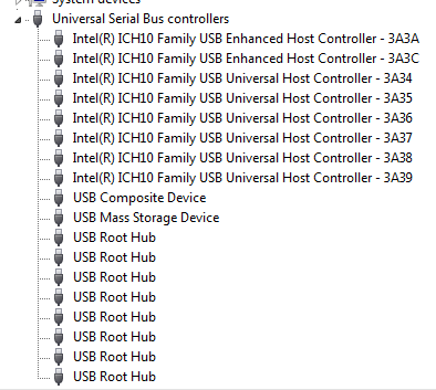

I see no exclamation marks. Is it normal that "USB root hub" appears two times?

I have 8 hubs on my desktop.
Have you tried shutting it down and then re-booting? When you right click on the HUB and look at properties, does Windows report that the HUB is working properly? From the right click menu you may want to try to disable then re-enable the hub. If that doesn't work, uninstall the driver and then re-install. If you uninstalled a driver, Windows should automatically re-install it on a cold boot-up.
