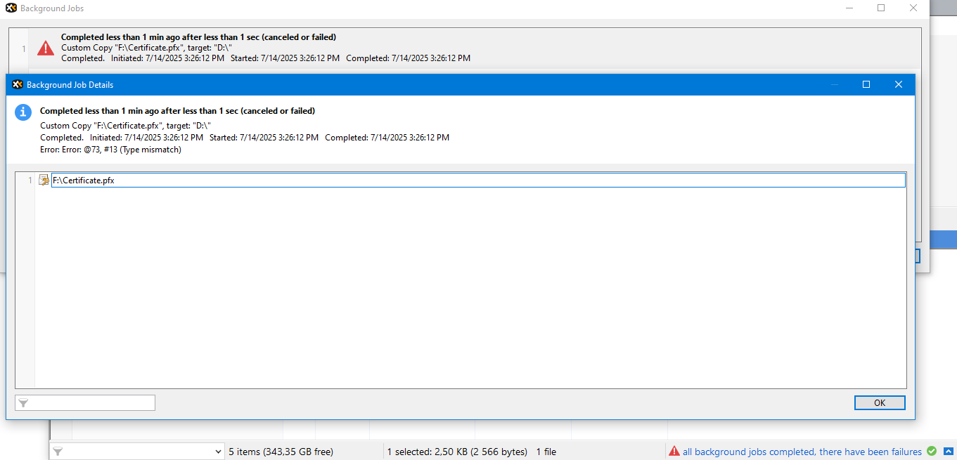

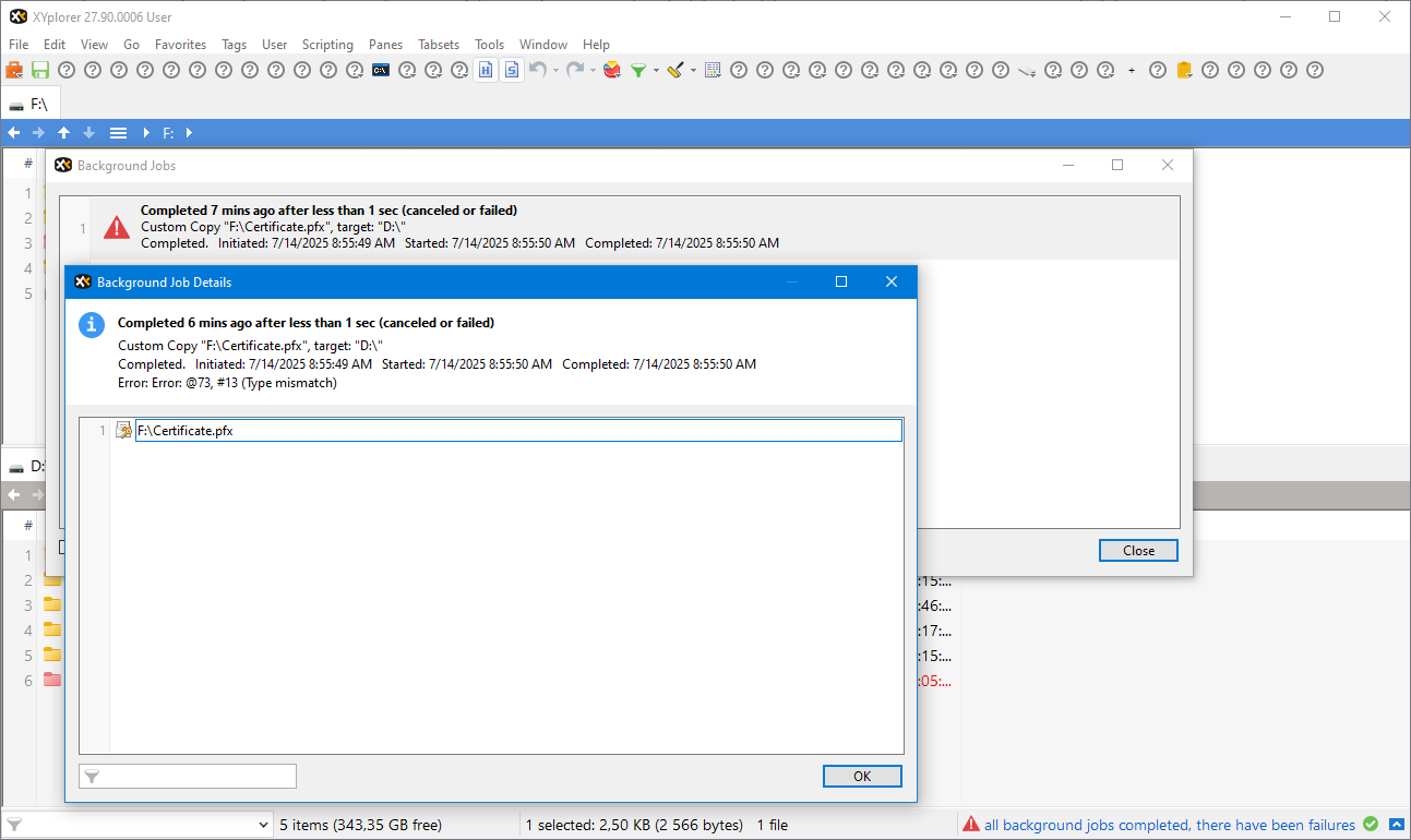

I'm sorry, I deceived you, I was already confused myself and reported that there was no error, and the parameter was set to FopInBackground=0.
If FopInBackground=1, then there is an error when copying in version v27.90.0006.
I apologize again.
I apologize again.

Re: XYplorer x64 27.90.0002 beta
There is also an error in 27.90.0007 if FopInBackground=1, if FopInBackground=0, then there is no error.
Windows 11 Version 24H2
- Posts: 67119
Hm, I expected a different error message. Are you positive that this is v27.90.0007?
