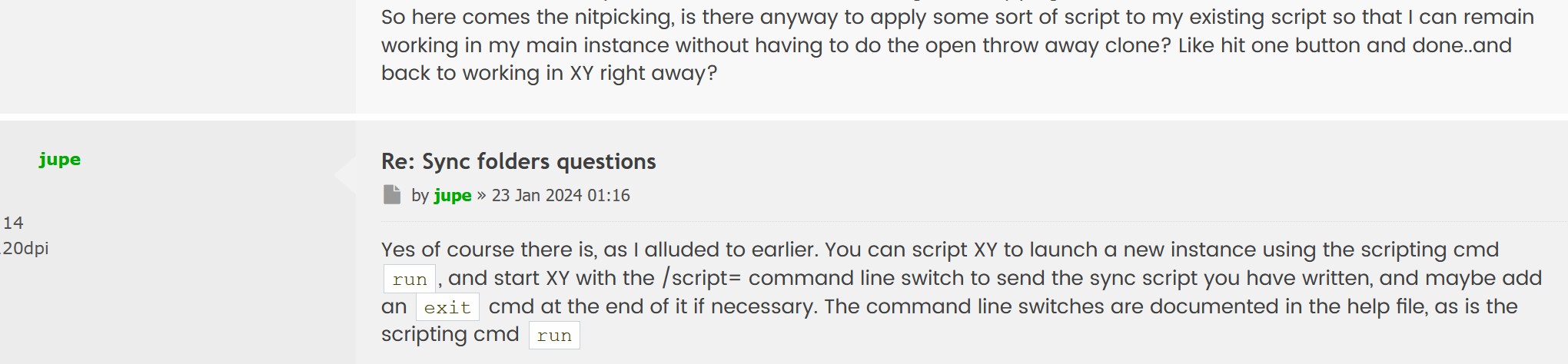

Tried this and had to cancel the run. It seems I'm still unable to use XY while it is running and that I will need to run it in the throw away clone or fresh instance in order to use XY again?
Is there something further that I should configure?
- Posts: 15016
Re: Sync folders questions
This has been said multiple times, you need a second instance if you don't want to block the main one during sync

You could run that script in a throw-away clone if necessary, again: via scripting
The script I posted should be put in a .xys file (create a normal .txt one, rename it, e.g. in: Sync.xys)
Put Sync.xys in your XY scripts folder
Append one more line to that file (at the end, indented by 4 spaces):
Use a user defined button with this "script":
Edit the position parameters if necessary.
If you'd use "n" instead of "kn" in the two sync ... lines in the script file (to NOT keep the sync report open)
it would start a clone that loads and executes that script and automatically exits that second instance when done...
exit "n"; and save it again.Use a user defined button with this "script":
run lax("<xy>" /new /readonly /win=normal,40,20,1200,800 /script="Sync.xys");
