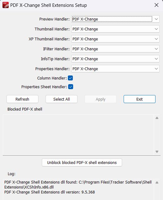

Horst, thanks for the tips, tried this as well, even followed some regedit advice from Tracker Software to enable the shell extensions but still no joy.
When I open that XCShInfoSetup.exe, I get the following screen now:
The "Blocked PDF-X shell" seems intriguing but the button underneath does nothing to change this state (even logged in as Admin).
Ralph :)

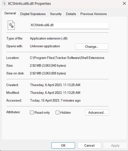

May be a strange idea but did you try to see the properties of the DLL
in Windows Explorer and may be unblock it from its General tab ?

@Horst: The properties of the DLL have no (obvious) way of unblocking it, see screenshot below:
Advanced just shows some archive/compression options.
