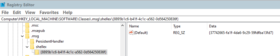

Then search for the GUId of this preview handler in the registry and add its Id from the Default entry in XY config.
The following is an example how it looks for the msg entry in the registry
Screenshot - 03.09.2021 , 18_42_52.png (13.97 KiB) Viewed 3640 times

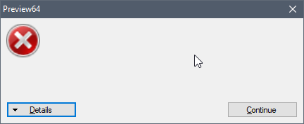

Posts: 14639
Re: Preview .msg files "No Preview Available"
The new feature to be able to state which bitness a preview handler has, is imho a bit fishy...
msg>{37742665-fa1f-4da6-9c29-59fdfba13fd7}>64
Leads to:
See the end of this message for details on invoking
just-in-time (JIT) debugging instead of this dialog box.

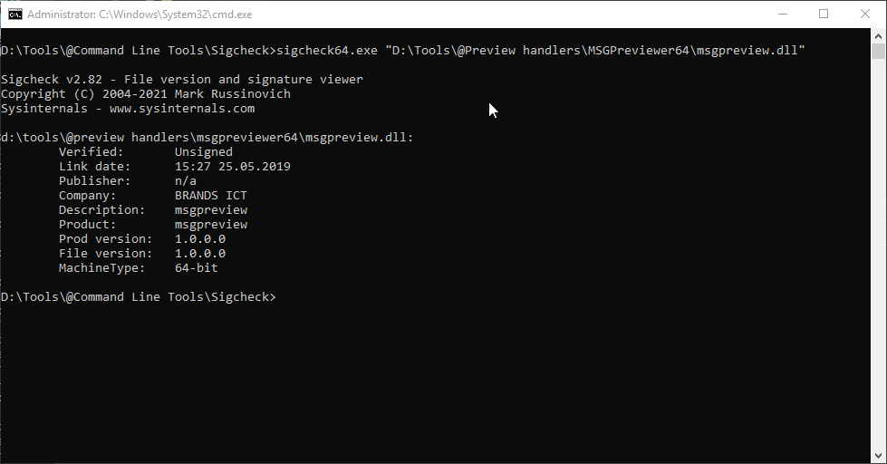

But this is definitely a 64-bit handler^^
