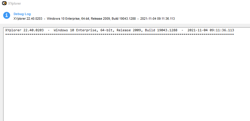

admin wrote: 04 Nov 2021 15:28 Do you see anything in the debug log? Use this script to show the log:
dlog;
The window appears but is also empty (nothing below the header info).

In the next beta (v22.40.0206) there WILL be debug logging, and a special killer command:
1) Add the following script to Configuration | General | Custom Event Actions | Other Events | Exit: dlog; and select action "Run script" for that "Exit" event. When you exit the app the debug log will be shown and should contain some info about killing XYcopy. Show the log.
2) If you see XYcopy instances hanging around after queued background file operations are completed, try this script, it tries to kill all processes called "XYcopy": killxycopy; Does it?
1) I have added this in prep for .0206. Currently it pops up the blank window as above.
2) I'll stash that for when you release the above beta.
