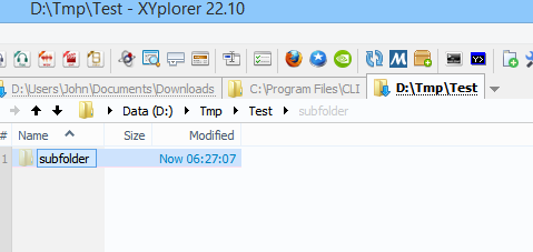

HI All,
I just noticed a little problem with tab headers and I thought that it might be related to this. If not I apologise.
I set a tab's home and then set "Lock Home Zone" on the same tab. Then I set an icon for the tab (right-click->Rename Tab). After this, if I navigate to a subfolder by double-clicking on the subfolder the tab header does not change to reflect the folder change.
If I remove the icon, and navigate to the same subfolder the tab header does update to reflect the folder change.
Initial state:

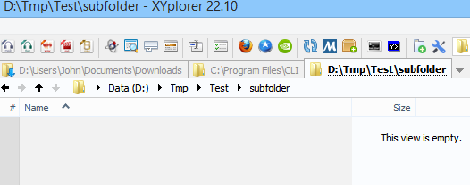

Change to the subfolder (double click the folder name) and the tab header is updated :) :

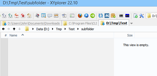

After setting the tab name with an icon (tab name is: "|D:\Users\John\Documents\settings\XYplorer\Icons\Downloads folder.ico"):

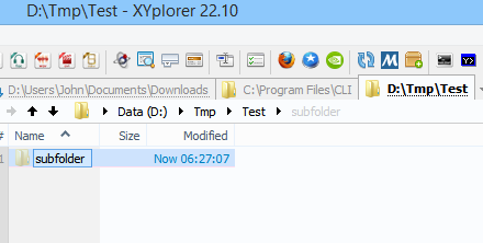

Change to the subfolder (double click the folder name) and tab header is not updated :( :

Update: switching to the other pane causes the tab header to be updated correctly.

Alright, confirmed and fixed. :)
