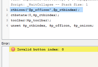

Edit 2: I came across an issue which is also present in your version 2 of "expanddrivebutton.xys". I first saw it on my modified version, only in the waitcollapse mode. After pressing the CTB button initially, you press the same CTB (i.e., the original button assigned, not one of the expansion drive buttons) a second time during the wait period (I'm using 5 seconds) you will receive an error message, "Invalid button index: 0". I've been stepping through the script, but it's difficult to determine exactly what is happening. Obviously, pressing the CTB a second time within the wait period should simply reset the state back to "0", but it's still in the wait state so when the time is up (5 seconds), the variables are probably fouled up. Possibly one way to handle this error would be to recognize when in the waitcollapse mode and the ctbstate is already "1" then hitting the same CTB again would have no affect since the expanded CTBs will go away automatically in a matter of seconds. The other way would be to some how cancel the wait state in progress (I'm not sure if that's possible). I should also note that the same error will surface if you hit one of the expanded drive buttons and then go back and hit the original CTB within the wait period. I suppose this issue would be one argument for "replacing" the CTB with the expansion buttons in lieu of adding them to the CTB for waitcollapse mode... the CTB wouldn't be there to press. :)

Hi serendipity, I didn't get a chance to get back sooner, but I did resolve the error message issue I explained in my above post Edit 2. I probably wouldn't be using the wait collapse option, but I wanted to take care of it anyway. I simply inserted a flag using a permanent variable in indicate when the script was in a "wait" state. The script checks if you attempt to run the script again by clicking on the CTB.
else { perm $wait = "ON";
  run "cmd /c ping -n $collapse 127.0.0.1 >nul & cd /d <xypath> & xyplorer.exe /script=""::load 'ExpandDriveButton.xys','_WaitCollapse'"" /flg=2", , 0,0; }
and then in the beginning on the script I added this if statement after the two lines that set the on / off icons...
if (($collapse >= "1") AND ($wait = "ON") AND (ctbstate(,$p_ctbindex) == 1)) {end(1==1);}
I also unset the $wait variable at the end of the sub "_wait" and unset $p_toolbar in sub "_waitcollapse and "_autocollapse".

But with the current beta 13.10.0115 I get the following issues with the script downloaded from the opening post.
1) No matter what $collapse is set to, upon expansion I get always another XY instance opened on top. :?:
2) Additionally with e.g. $collapse=3 on the new instance the following SC error pops up.
Edit: my CTB has number #32 which I also used to set $p_ctbindex.
May I have picked an older script version?

Hi Filehero, So did it seem to work properly before v13.10.0115 or did you first try it after updating to that version? It is a very useful great little script that serendipity concocted. My personnel script based on serendipity's first post, as you might imagine from the later posts, is quite bastardized. I'm not using it for drive expansion, but expansion of CTBs I've selected and different ones expand for left click and different CTBs for right click along with different icons for off and on. Anyway, I downloaded the script in post one and loaded it with a new CTB and it worked fine using v13.10.0115. Are you sure you used the CTBindex as "32" not #32 (e.g., $p_ctbindex="32";). I received an invalid button index when I had #32 or in my case #18...you're running out of buttons! If you haven't yet, once you resolve your issue, try "$collapse=-1;". It's definitely the way to go.

yes, it's my first try after updating to v13.10.0115.
I added the index properly without the hash (though it doesn't matter if it's quoted or not). Testwise I changed the script to use user button #10 (with plenty of free buttons remaining). However, the problem of the second popping XY instance is the same. When I have more time I'll try to hunt that down.
Thanks for help!

In trying to resolve the issue, please take a look at my two post starting here http://www.xyplorer.com/xyfc/viewtopic. ... =30#p93023 that concerned the timed wait option for drive collapse. I experienced something similar to what you have until I made the changes discussed. Also, when you hit the drive button a second time during wait mode strange things will happen. Script changes I discuss were made to make sure a second press of the original drive button does nothing in the wait mode until the time has lapsed. Note the changes addressed on permanent variables.
Also make sure the script called has not been renamed or the run in this line will not function properly unless you change the script name.
I know you are using Windows 8...you can use serendipity's earlier command
run "cmd /c timeout $collapse & cd /d <xypath> & xyplorer.exe /script=""::load 'ExpandDriveButton.xys','_WaitCollapse'"" /flg=2", ,0,0;
instead. It can only be used on Windows 7 and above due to the use of the newer "timeout" command. I think serendipity may have take it out of version 2 such that the line worked across all systems.
Good luck. I can send you my version via PM if you want (I've been using it for a few weeks now without a problem).

What happens when you run this addressbar?
run "cmd /c cd /d <xypath> & xyplorer.exe /script=""::msg 'Hi!';"" /flg=2", , 0,0;
Posts: 2731
Re: Expandable drive button
serendipity wrote:What happens when you run this addressbar?
a new XY instance opens in the foreground which then creates the "Hi!" popup. What do you expect to happen?
Obviously I'm the only one having this problem. Strange.
