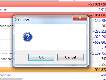

Still not perfect. Do you have any advice?
- 2016-05-28_19h51_48.png (27.05 KiB) Viewed 6026 times

Do know that it's on my list. I had some really, really busy days.
It's an effect of the change of precedence of the dot operator. The script works just fine, only that message is blank. I'll (hopefully) upload a beta fix soon.
Re: SimpleUpdater — Rev. 10.67 / 2015/06/14
Line 194.
Find
Replaceed. Whoo, no offense but parsing ((nested conditions)) AND ternaries (in (one line))) is tough if you didn't brew it yourself...
ed2. I'm still not 100% sure this is the correct "patch"...
Find
if (confirm((("$major_changelog" == "1" AND compare("$major_version", "<xyver>", "v") == "1") OR "$beta_changelog" == "1")?"":"$str00500_yLb2oLZnSvh3<crlf>"."$str00600_yLb2oLZnSvh3") == "0")Code: Select all
if (confirm(((("$major_changelog" == "1" AND compare("$major_version", "<xyver>", "v") == "1") OR "$beta_changelog" == "1")?"":"$str00500_yLb2oLZnSvh3<crlf>")."$str00600_yLb2oLZnSvh3") == "0")ed2. I'm still not 100% sure this is the correct "patch"...
Yes Sammay, your patch is correct
I must confess that I had to recall what exactly I wanted to achieve with that ternary
I'll upload the final tonight.
Maybe you thought about alternating between "A new version of XYplorer is available." or "A new beta version of XYplorer is available."? This whole line goes missing currently.Marco wrote:I must confess that I had to recall what exactly I wanted to achieve with that ternary
Re: SimpleUpdater — Rev. 10.68 / 2016/06/01
More or less.
The script workflow is:
-show changelogs (if changelogs are enabled)
-ask the user if he wants to update (if such prompt is enabled)
If changelogs are actually shown (and they're only shown when there's a new version) then the user knows that there's a new build available, so there's no point in saying "Hey there's a new version. Wanna update?". I'll just say "Wanna update?". However, if changelogs are disabled, I'll go with the full phrase.
I know, subtleties
