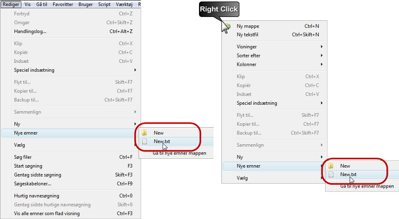

Hello again
Possibly my mistake, but I can't translate the two entries (8.24) below.
I'm guessing on these two:
ms.1185=01|New.txt|--|Ny.txt
ms.1186=01|New{menuitem}|--|Ny
But XYPlorer doesn't seem to read the translation.
Kind regards
Regmos
Regmos
Marco
- Posts: 2354
- Joined: 27 Jun 2011 15:20
Re: Multilingual Support
Those items don't appear in translation because that's a listing of items found in Data\NewItems. Don't worry.
Borut
- Posts: 1472
- Joined: 19 Oct 2010 19:29
Exactly as Marco said. Additionally, you can find more about that in help, if you copy and paste the following line in address bar:
If for instance a Danish user puts Danish-named files/folders in that directory the effect should be seen.
::help ("idh_menedit.htm#idh_meneditnewitems")Win 10 Pro 64bit
