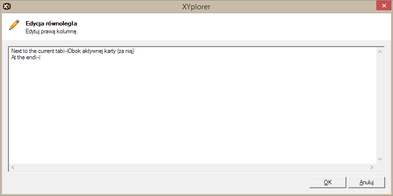

I have noticed strange thing on my home PC when I open Configuration and I am not sure if this is translation fault.
But after Configuration window appears I can see many items not translated in it.
Error 380
Error: 380 (0x0000017C)
Desc: Invalid property value
Dll: 0
Proc: readCombos
Source: XYplorer
XY ver: XYplorer 21.40.0125
OS: Windows 7 Home Premium (Service Pack 1), 64-bit, Build 7601
Locale: 1045 (pl-PL)
ANSI: 1250, ACP: 1250 (ANSI - Europa Środkowa)
Font: Microsoft Sans Serif 8,25, DBCS: No
DPI: 96 (100%), 1920x1080
Date: 2021-01-12 21:01:09
I will check my work PC tomorrow to see if I have the same behaviour.

As it may have some private date, I have sent it via PM.
I will remove from given link after 24h.
P.S. I have checked work-PC and no such issue there. Only home PC is affected.
PS. 2. Will send PM again. Noticed wrong INI (work). Just give me few minutes.

It's indeed caused by a translation error. You have not translated "At the end":
I will take care that these kinds of errors will not happen again.
I'm also surprised that the Interface Translation Tool did not catch this error. I'll check that as well...

Could you recheck with updated version?

Yes, fixed! I'll upload that file.

Thanks, this issue lead me to improve a code section in the configuration dialog.
