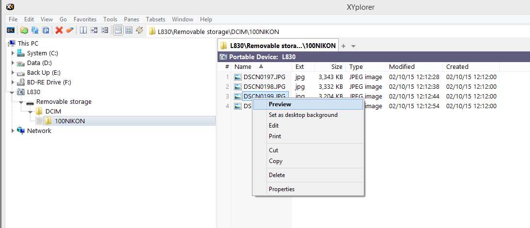

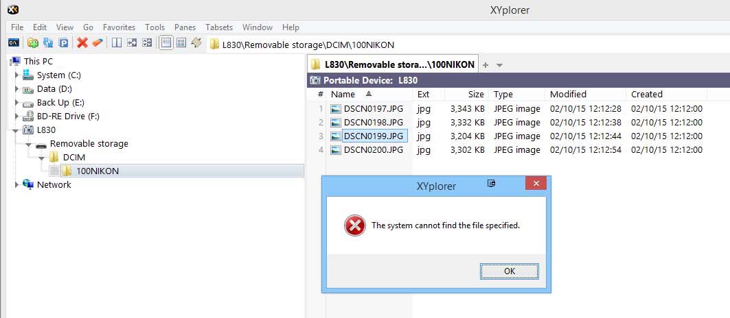

When in a portable device folder, double-clicking on a file gives a 'The system cannot find file specified' error.
but right-clicking brings up the context menu, and executing an option there does function properly.

Shadow wrote:When in a portable device folder, double-clicking on a file gives a 'The system cannot find file specified' error.
http://www.xyplorer.com/xyfc/viewtopic. ... 40#p117740
If that list is still correct (and I think it is) then opening is not yet supported and is not planned for v1 of PD support.
Posts: 67146
Shadow wrote:[FlameArrester] I read back through most posts and did not see this discussed, but I may have missed it.[/FlameArrester]
WE does successfully launch the associated default program on double-clicking a file.
v14.80.0229
win8.1/64
Funnily your post inspired me to see the solution! :biggrin: :appl: Next version *might* support the dbl-click. It works fine here (Win8.1).
