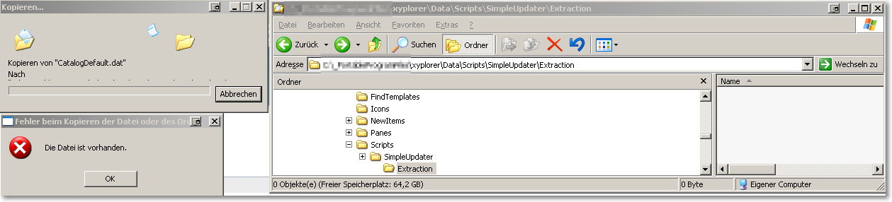

Since several beta versions after 12.90 I am experiencing the following:
At the point where downloaded and extracted files are to be copied to their final positions, an info-dialog shows up, informing me that a file already exists (CatalogDefault.dat, most probably the first file tried). By clicking on OK the story ends, in a sense that the old files are *not* being overwritten with the new ones. The old XYplorer version then restarts. The script "thinks" that the update has been completed successfully.
I suppose that this:
- does not have anything to do with XYplorer itself,
- does not have anything to do with SimpleUpdater.xys either, since it has not been changed since April.
On my WinXP machines current Windows Updates have been done recently. This seems the most likely cause to me (in the absence of better ideas).
Anyone else with this strange experience?

Borut
- Posts: 1472
- Joined: 19 Oct 2010 19:29
Re: SimpleUpdater — Rev. 10.66 / 2013/04/24
I am not aware of any. XYplorer closes correctly before that point (and I am running only one instance).
I must admit that I am lost now: I have now removed CatalogDefault.dat from the xyplorer folder prior to the update try. However, I am still getting the error message (from German, the upper one: Copying... Copying "CatalogDefault.dat" into... (target path is not visible); lower one: Error while copying file or folder. The file already exists.)
I notice that at that time the Extraction folder appears to be empty. Strange. (Where are the extracted files?)

OK Marco, I believe I have found the cause (at least approximately). First of all, it seems to have nothing to do with Windows Updates - I have noticed that different machines behave differently (on one the script succeeds, while not on the other) although they both are on the same Windows Update status.
In my temp directory, I have found 99 directories named in the following way (German Windows):After deleting them manually, the Simple updater completes the process perfectly again.
I am not sure in which phase of the update process such a temporary directory is being created - I presume that it is during the decompression, since these actually contain the XYplorer files contained in the zip.
My hypothesis is, that after the 99th directory no new one is being created (for some mysterious reasons), which then somehow leads to the collision, which prohibits the completion of the process.
Temporäres Verzeichnis 1 für XYplorer.zip
Temporäres Verzeichnis 2 für XYplorer.zip
Temporäres Verzeichnis 98 für XYplorer.zip
Temporäres Verzeichnis 99 für XYplorer.zipI am not sure in which phase of the update process such a temporary directory is being created - I presume that it is during the decompression, since these actually contain the XYplorer files contained in the zip.

Thanks for the debug Borut!
When you say "temp directory", what do you refer to, Windows %temp% or the temporary folder where I perform the zip extraction (and which should be deleted after a successful update)?
Because in the first case I'm afraid there's not much that I can do - Windows should handle its temporary folder(s) properly by itself.
BTW, you're talking about XP, right? I use 7 regularly, and after an XY update nothing in my %temp% about XY is left over.
