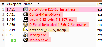

Post by bdeshi »
VirusTotal Reporter Custom Column Edition.
Read more at original script thread:viewtopic.php?f=7&t=11360
Xyplorer takes care of sorting! (:whistle: can't say the same about the script)
type ::snippet; in the addressbar and paste the following code:
Snip: CustomColumn 1
  XYplorer 13.90.0112, 4/17/2014 9:31:22 PM
Action
  ConfigureColumn
Caption
  VTReport
Type
  3
Definition
  	$thisHash = "" ; $vtURL = "" ; $vtReturn = "" ; $vtGet = "" ;
  	// if item is not a folder
  	if (<cc_isfolder> != 1) {
  		$fsize = filesize(<cc_item>);
  		if ($fsize <= 67108864) {
  			unset $fsize;
  			$thisHash = hash("sha256", <cc_item>, 3) ;
  			$vtURL = "https://www.virustotal.com/en/file/$thisHash/analysis/", "r" ;
  			$vtGet	= readurl("$vtURL", 1, 1, 1) ;
  			$vtReturn = regexmatches($vtGet, '^[\d]+\s/\s[\d]+') ;
  			unset $vtGet ; // it's relatively large, the less used the faster ;)
  			if ($vtReturn == "") {
  				return "N/A" ;
  			} else {
  				return $vtReturn ;
  			} else {
  				return ">64mb"
  	// if item is a folder
  	} else {
  		return "---" ;
Format
  0
Trigger
  2
Item Type
  0
Item Filter
A custom column VTReport will be created. Now just add that column to the list.
even though it's by default a clickable CC script, check in configurations if trigger indeed is 'click'
Don, It seems trigger type is not set correctly via snippets? it always sets trigger to 'browse'?
Each report is parsed from a webpage, so don't change the trigger type to something else, unless you want to try and suffocate XYplorer
REMEMBER, NO ANTI-MALWARE SOLUTION IS PERFECT! ALWAYS BE SUSPICIOUS OF SUSPICIOUS FILES!
