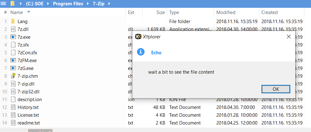

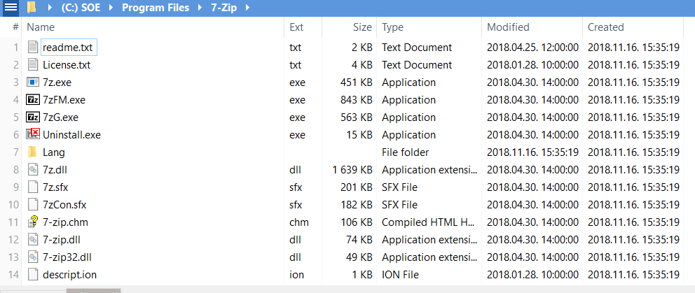

I am answering by an extension of your script to show where the flicker comes from:
//test
  echo "wait a bit to see the folder content";
  if (<newpath> Like "*\Program Files\*") {
    sortbylist "Readme.txt|License.txt|*.exe", "|";
Not everybody's computer is that fast.

admin wrote: 09 Dec 2020 18:37 Nope, no contents here. Must be some setting. Try fresh...
I made a mistake with the script. Echo should have been in the if section.
//test
Version
into the 7zip folder ("file" is a mistake in the message. should be "folder")
after clicking on "ok"

LittleBiG wrote: 09 Dec 2020 18:46
//test
[... pictures ...]
LittleBiG, if I understand correctly, you expect that the list, that is visible behind the echo-dialog should be empty.
Instead it is already painted with the default sort order.
Therefore, it flickers when your custom sorting command is executed.
If that is what you mean, then yes, I can confirm that. It also happens on my computer as well, just that I don't see a flicker (without the echo-dialog), assumingly because my computer is faster.
BTW, I am on Win 8.1

autocart wrote: 09 Dec 2020 19:59 ...If that is what you mean...
Yes, I meant that. Also, it depends on the number of files in the folder. And I have folders with lots of files.

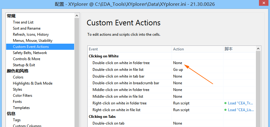

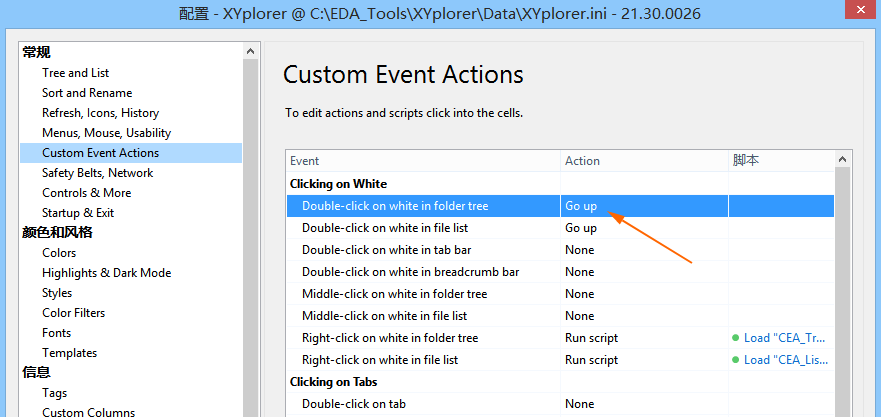

"Double-click on white in folder tree" is set to "Go up" and "Double-click on white in file list" is set to "Go up".
Click "OK" to close the configuration dialog box. Then open the configuration dialog box, "Double-click on white in file list" is set successfully, "Double-click on white in folder tree" is not set successfully.
Do you have such problems?
Thank you.
autocart
Posts: 1388
Joined: 26 Sep 2013 15:22
Re: CEA - Custom Event Actions
Post by autocart »
kuiwu_zh wrote: 10 Dec 2020 02:26 "Double-click on white in folder tree" is set to "Go up" and "Double-click on white in file list" is set to "Go up".
Thank you.
confirmed

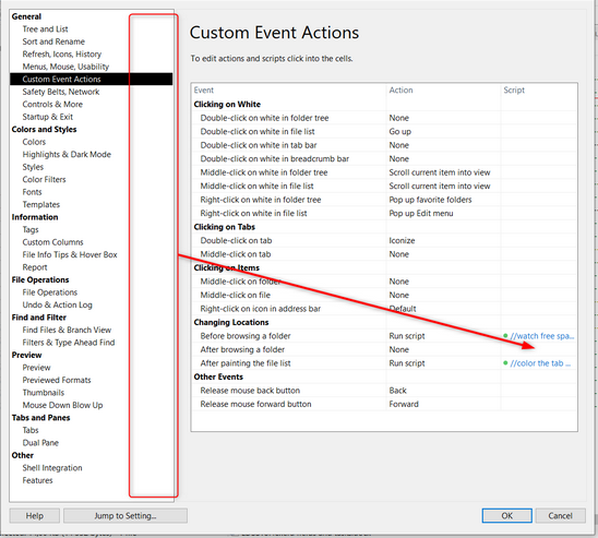

Just my 2 cents, it is hardly possible to be brief enough to put useful information into the first row of the script for showing it in the script column of CEA configuration.

LittleBiG wrote: 09 Dec 2020 20:21
There might have been 2 factors:
- Autosize Columns set in before event "After browsing a folder". I fixed that now.
- the message box itself (echo...) causes a list paint because the list loses its focus (classic observer's paradox)
So, test the next beta...

LittleBiG wrote: 10 Dec 2020 11:50 Just my 2 cents, it is hardly possible to be brief enough to put useful information into the first row of the script for showing it in the script column of CEA configuration.
I agree that it is not a lot of space. Like I wrote before: I am sure that there could be a better solution, but do you have one? Why did you not share it with us?
Posts: 66616
How many characters do you need to see?

autocart wrote: 10 Dec 2020 11:56
Because it can be no good for the other tabs. Sigh. Ok, I show now.
