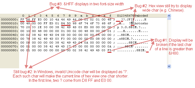

The biggest bug (selecting/deselecting changes the raw view) has been fixed!
But there are still few bugs:
2009-8-16 19-12-44.gif (18.25 KiB) Viewed 1962 times
Tested on v8.20.0007.

Thanks for the feedback and the effort! But I have to stop here. Run out of ideas. Maybe, actually surely, inspiration will hit me later... :)

Sorry: I don't understand the situation.
I'd expect, that for the character-part of the dump each (single) byte of the data is represented by it's character-value, if any.
That is: just replace any non-printable byte of original data by '.', and then print it (as single-byte data).
(OK - with some formatting for 16-byte-parts and such...)
That sounds so very easy?
Or do I understand something wrong?

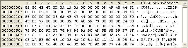

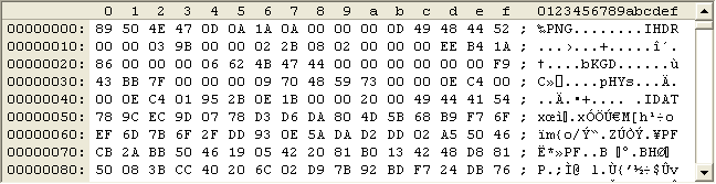

I would do it if it was not for the "PNG" results you gave me. The first character is ‰ (ASCII 137, 0x89, resolved to the extended char U+2030!). If I zero all high bits then this character would not be shown (at least not on my system) -- but all Hex Viewers I've seen (including yours!) do show this character as the first of PNG files.
With extended chars (as it should be I think):
Without extended chars:
Re: Raw view could not display Unicode correctly
