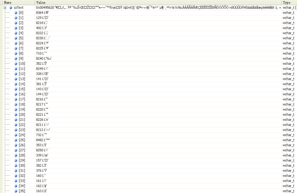

Finally got it works! In C++:
You can check out _mbstowcs_s_l, _create_locale and _free_locale in MSDN.
Test data and screenshot:
The source string szTextA is a 129 bytes array from 0x80 to 0xFF, plus a terminated 0. The attachment is the converted wide string.
_locale_t loc = _create_locale(LC_ALL, "enu"); // the only secret
size_t n;
_mbstowcs_s_l(&n, szText, 1024, szTextA, _TRUNCATE, loc); // szText[1024]
_free_locale(loc);Test data and screenshot:

Thanks, I never heard of these functions. Why "enu"?nf_xp wrote:Finally got it works! In C++:You can check out _mbstowcs_s_l, _create_locale and _free_locale in MSDN.Code: Select all
_locale_t loc = _create_locale(LC_ALL, "enu"); // the only secret size_t n; _mbstowcs_s_l(&n, szText, 1024, szTextA, _TRUNCATE, loc); // szText[1024] _free_locale(loc);
I will try something with MultiByteToWideCharPtr and CP_ACP...

MultiByteToWideCharPtr and CP_XXX wouldn't work, that was my first try.
"enu" is the language string for English (United States).
