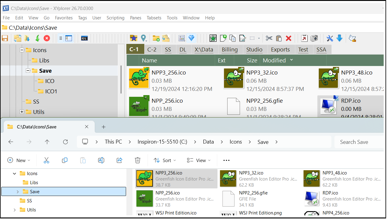

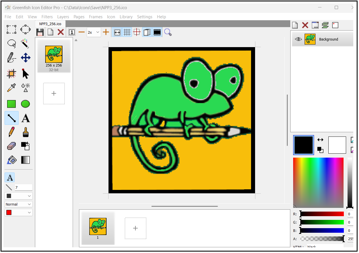

Don, I finally have a reproduceable scenario, hope this helps.
Below, I am editing an existing icon using Greenfish Icon Editor Pro 4.0
  • I added a black border and exported the change to the same file
  • XY does not show the update
  • Win File Explorer immediately shows the update
  • Even after hitting all the XY refresh options, restarting XY, and restarting the PC, the update is not shown
  • However, after restarting the PC, selecting icon and selecting Refresh Selected Thumbnails the icon is updated

I was actually able to reproduce this weird thing. It's specific to ICO files. ICO files are kept in a special cache by Windows, and they are sometimes a bit stubborn. But I'm surprised how stubborn they are! Not even restarting the process (XYplorer) helps! I don't have a solution at the moment. XY lives in the truth told by Windows :|
PS: If you duplicate the file, you will see that the duplicate will be updated correctly. So two 100% identical files show different icons, thumbnails, previews. Unreal.
