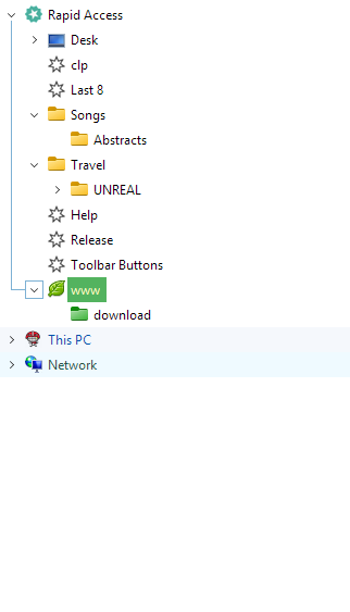

Re: Rapid Access
Hmm, maybe I did not explain it well enough. It's a game changer. Maybe you should read the Help about it? Or look here: https://www.xyplorer.com/release_26.00.php
ADD: You know, even with the Mini Tree, if the locations you are currently interested in are deep down on different logical drives, your tree gets high (you have to scroll up/down) and your paths get long (you have to scroll left/right). With RAF, you can have all these locations in one place. Perfect.
This is my tree now. Awesome. 99% of the time this is all I need:
