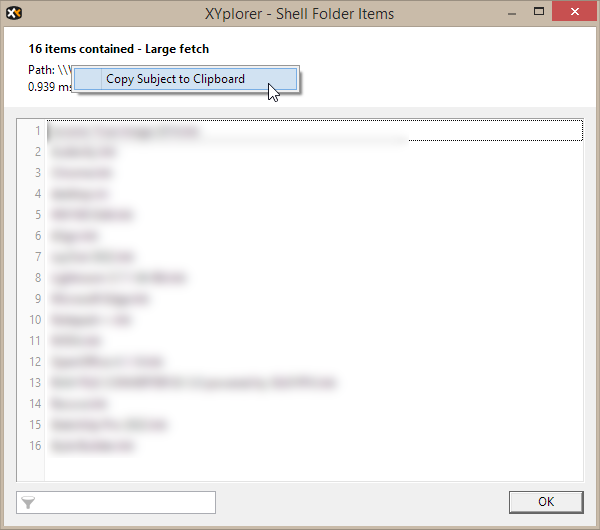

Okay, let's do some research!
In the next beta version (v26.30.0402) try these three scripts and post the results (right-click the header section and click Copy Subject to Clipboard (see attached image); the listing itself is not needed for the research). It will be interesting what time difference we'll see.
enumshellfolderitems "your network path", , 0;
enumshellfolderitems "your network path", , 2;
enumshellfolderitems "your network path", , 4;To see the attached files, you need to log into the forum.
mussor
- Posts: 78
- Joined: 05 Sep 2022 11:42
Re: slow browsing on network drives
"(feeling adventurous)"
I run them multiple times:
for 0
155 items contained
Path: \\server\share\data_share\***\AutoHotKey\old
329,312 ms
155 items contained
197,318 ms
155 items contained
95,243 ms
155 items contained
183,623 ms
for 2
155 items contained - Small fetch
Path: \\server\share\data_share\***\AutoHotKey\old\
33,954 ms
33,922 ms
38,660 ms
31,929 ms
for 4
155 items contained - Large fetch
43,382 ms
1,124 ms
32,913 ms
1,098 ms
29,292 ms
29,717 ms
1,107 ms
36,622 ms
(Those numbers are wierd. The last one - 36,622 ms I would say it took 36sec? But the list showed after a second or so.)
those *** are only to make the post more anonymous)) there are just normal letters there

- Posts: 67076
Weird indeed. What is the thousand separator and the decimal separator on your system?
BTW, over here flag 2 is clearly the fastest in all folders I tested (though the difference to flag 4 is small).
BTW, to test the current folder simply use this:
enumshellfolderitems <curpath>, , 2;FAQ | XY News RSS | XY X
