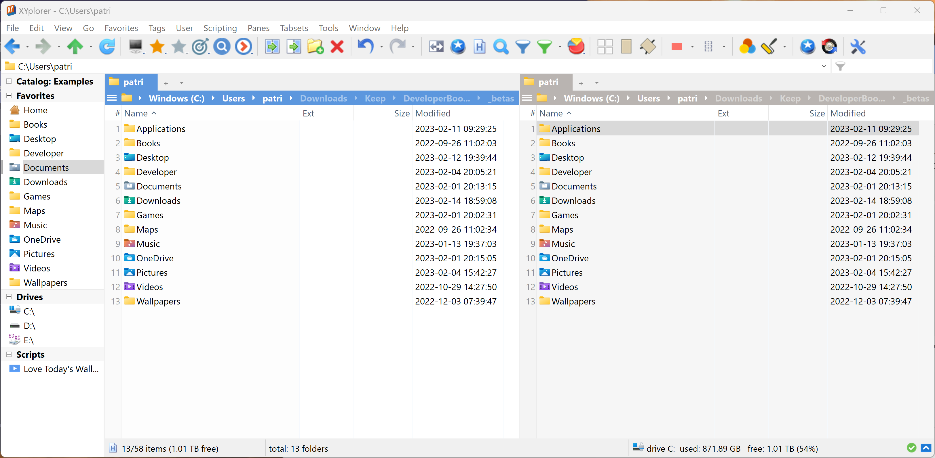

Can you show a screenshot of the XY window of the moment before you do the fatal click?
Re: version 24.00.0700 does not work
Posted: 15 Feb 2023 01:07
by rhywun1
I gave up and went back to 24.00.0600 but here is a screenshot - it looked exactly the same previously.
