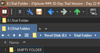

However, as can be seen from the 1st picture; the number is too small. Is there any problem here?

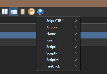

Also, the menu doesn't open when clicked.
Was it the right way of working that it didn't open?

No the text size is normal, to increase it you would zoom your toolbar with Ctrl+Wheel over the button, or use the Customize Toolbar dialog.
The second image you posted is your failed attempt at adding the button, probably from before when you weren't following the instructions I just posted, you should Edit... that button and press the Clear button in the dialog and then remove it from your toolbar.
