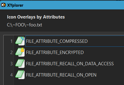

Re: Is it possible to show OneDrive file status?
In the next beta try this: sysicons a, 0;
Posts: 1419
Joined: 24 Jan 2021 12:27
Location: Germany
Post by Horst »
It looks like this now
Everything 1.5.0.1425b (x64), Everything Toolbar 3.5, Listary Pro 7.1.0.47 beta
Posts: 67337
Well, this cloud overlay or cloud icon is apparently not available for third-party apps. It's probably embedded in Explorer.exe. So I could just emulate the cloud with an overlay I made myself. This is not nice, since all possible icon sizes have to be served.
